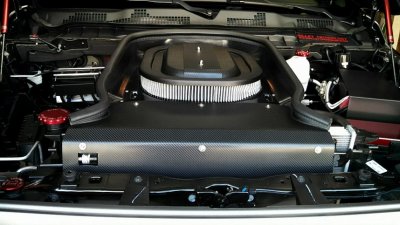

The Vararam tends to make a little more power, and the S&B appears to be better quality... I have had the Volant, and I now have the Vararam. The Volant was great, but I like the looks of the Vararam better (I modified mine a bit).

DavidRam you need to remove that stock airbox bracket. Thing sticks out in the pictures.
Only problem is the stock airbox bracket supports the inner fender.
I didn't know that. Well now I feel like a ****. ha
Nah, I didn't know it either till I went to rip it off when I put in my Vararam....
Now the thing to say is DavidRam need to make a nice fancy bracket that looks better to replace the ugly stock airbox bracket and then make one for me too hint hint wink wink

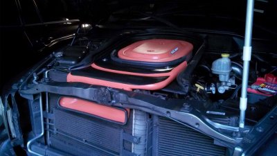

This is what I did. I love the Air Grabber, but they don't make it for my gen III so I grafted one to fit with a custom snorkel air ram scoop I made using the "lost foam" method. It not only looks old school, but it's functional and I have already seen an increase in my gas mileage from just adding the snorkel scoop. It feeds air from the high pressure area in the front of my grill as you can see directly into the air cleaner. It detaches with "mini push latches", real cool, just push the buttons in and the scoop lifts right out and then "snaps" right back into place upon return. I'm going to add a functional hood with scoop later because the Air Grabber has been modified to seal to the bottom of my hood, I had to build the seals up in order for then to reach the hood, but now there's a seal ring around the bottom of the hood where you can see where it's sealing. Feedback is welcomed, suggestions?
