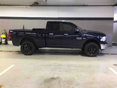

I just put a 2.5" on my 2015 ram 1500 this past weekend and I have 33x12.5r20 on it. They look tiny on the truck so 35s will fit. I bought new wheels that were 20x9. I have no rubbing, nothing is touching, etc. I think you'll be alright. I'm sadly considering buying 35s sooner than I thought :crazy:

Good looking truck. But yes that is exactly what I was afraid of so I got some 35's
Yes good thinking, But I have 20x9s and I can fit my finger between the upper control arm and tire. Everything is clear and I've had no rubbing. I hope this helps!

I have 33s, so a spacer would probably be needed for 35s. Like I said, I can only fit a finger in between my tire and control arm so I'd imagine they might need something. Your right, all tires are different too. I have M/Ts

No mine are 12.5" as well. 33x12.5r20s are what I put on

oh, ****....ok i didn't make the connection that you posted the pics of the truck with the 33's and the black wheels on the first page sorry about that.
your wheels are aftermarket so i'm guessing that they have less backspacing than stock wheels
