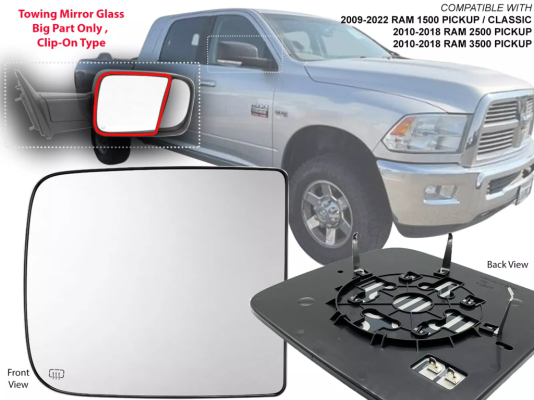

possibly this will help
Tow mirror
  • DIRECT REPLACEMENT:Replacement Door Side Tow Mirror Glass 100% fit RAM 1500 2500 3500 from 2010 to 2024
  • FUNCTION:Flat and Heated Glass with Back Plastic Plate and BLIS (Blind Spot Sensor Light)
  • REFERENCE NUMBER:‎68401393AA;68067727AA;68401392AA;68067726AA;68401395AA;68401394AA;68067731AA;68067730AA
