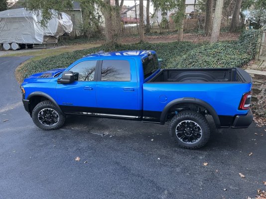

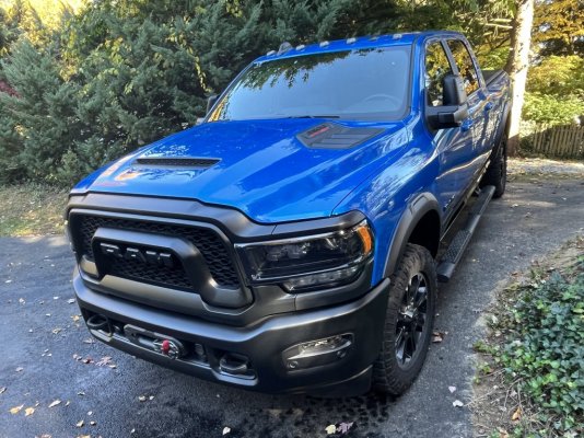

In 2023 they introduced a Power Wagon Rebel 2500. You give up some of the off road capability in favor of towing capabilites. I have a 2024 that has a 2964 lb payload capacity, Rear Diff locker and winch. No sway bar disconnect though, and much stiffer Bilstien suspension. My window sticker lists it as Power Wagon but there is nothing on the truck stating power wagon just Rebel.
Yeah, that was a confusing marketing decision by Stellantis. The Rebel in the 1500s is the top end offroader for that market segment. The Power Wagon is the top end for the 2500. The Rebel/PW for the 2500 is a mid-tier offroader. Figure that one out.
Ford and GMC have a progression they stick with regardless of market segment. An FX4 is an FX4, midsize, half ton, 3/4 ton, doesn't matter, it's the mid-tier. Tremor is the top, again, regardless. Chevy, ZR2 is always the top offroad for that segment. Ram just decided, nah, let's not make it that easy....
