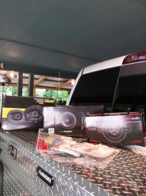

The speakers came in today. I got started as soon as the UPS man left. Everything went together nicely, and sounds ten times better. Sub install next.
