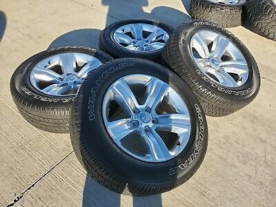

I have rims identical to the ones in this picture.03614275534c71fe4e05b69a59124efa.jpg
Sent from my SM-N960W using Tapatalk

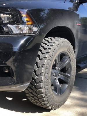

I have the same only in black. I have the Firestone MT/2’s in 35/20r/12.50’s.
They fit fine, no rubbing on control arms, no wheel spacers. They’ll stick out about an inch from fenders. image.jpg
