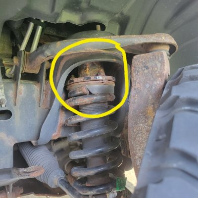

can anyone tell me what this is for..I cannot find it in any diagram...its the front ds where the spring goes..it looks like some type of leveler or something ..my problem started with broken end links..the stock ones seems too short and the broken one had some type of extension on it that caused the sway to pitch up and the stock one causes sway pitch too low..20220817_164953.jpg20220817_155606.jpg

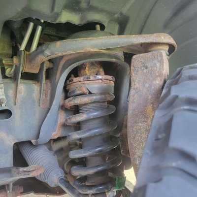

Sway bar end link, the long one looks like it's for a lift kit. SuspensionMaxx makes a slighly longer version for levelled trucks, not sure what lift you have if any. And that is a ton of rust.

here are better pics..the first is sway angle with old link..2nd with new link20220817_170159.jpg20220817_170132.jpg20220817_170102.jpg

thanks so much for the advice...gonna give thet a try
