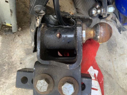

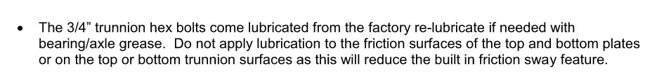

I’d have to disagree with that statement.
Kinda hard to see but mine specifically calls for grease and even has zerk fittings.

There is an old saying regarding WDH---"If it ain't making noise, it ain't working." Never oil the contact points between the arms and the hitch--that friction is necessary.
You want lube so the bars and ball can pivot freely, you don't use lube on a friction sway bar itself or if the manufacturer specifically states not to use lube on a WDH.
You won't effect how a WDH transfers weight to the front of the truck by using lube, the bars and hitch are pivot points where as the WDH applies leverage perpendicular to the pivot points of the hitch. Only thing no lube does effect is how much noise the hitch makes and the number of people hearing it wanting to tell you to put some lube on that hitch.
Nonsense, every time you make a turn there will be metal to metal grinding going on.

Maybe you guys are right----I was referring only to the bars; not the ball. Always grease the ball and socket.
I also agree that greasing the bars has no affect on their weight transfer role. Transferring load to the front on the tow vehicle happens as a matter of simple geometry--grease does not affect that.
The only area where greasing might have an affect--besides the reduction of noise--is the anti-sway component of the hitch. If the hitch manufacturer also claimed that the WDH reduces trailer sway, then greasing the bars will reduce that.
