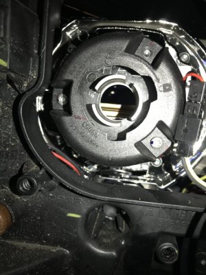

Loosen the 3 screws on the retaining ring that holds the bulb in place, rotate bulb so wire is at 6oclock, and retighten

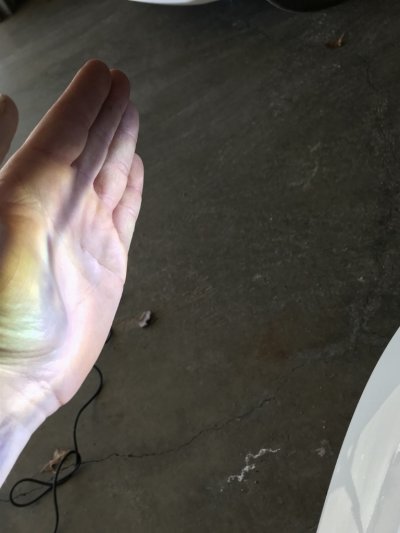

I can’t really tell. I feel like it’s better. Definitely much more crisp and clear no more dead spot. As far as better output I want to say yes but it could just be in my head too.
It’s definitely better than this! I don’t have any pictures of after I rotated it, but I did test it out last night and I was very pleased.

I took my headlight apart tonight and couldnt figure how to perform this fix. I saw the bulb mount on the assembly with 3 screws but when I unscrewed it, they are not equally spaced so I couldn’t rotate it. What did you do to fix yours? Also the bulb has no way to rotate the bar...

Do not take the 3 screws out. Just loosen them enough that you can freely spin the bulb. Put the wire at 6 o’clock and then tighten the 3 screws back up. The bulb will not be in it’s normal locking position, but it still will not move.
