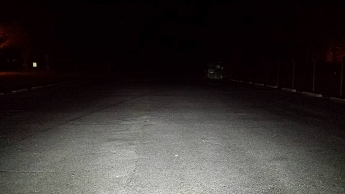

LED fogs from JJs website got it to match 5k hids.
Pretty bright imo. If anything they'll match :D. Plus phone camera doesn't do so well showing what it lights up. Better in person.
That looks pretty bright to me! At least to match a pair of HIDs like you said.. I think I'll go that route, HIDs lows and LEDs to match them in the fogs. Thank you good sir.
