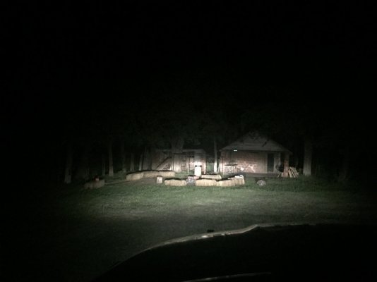

Being a college kid who could not afford a proper, full-on projector setup, I did the 50W 6000K H11 kit from Jeremy at RetroShop for the low beams in my quad housings. The low beam has a small cover directly in front of it so there is minimal glare and I have yet to be flashed ONCE by oncoming traffic since I installed them almost a year ago. I highly recommend this affordable setup as it is a huge upgrade over stock (or any other halogen) bulbs while still being considerate of other folks on the road. 40c0f7e5a921ec349238c5acf89502ae.jpg
Low beams only:
Low beams and light bar: 352b190acc3121df169c418df35b4fe6.jpg
Low beams only:
Uh....there is allot of glare based on your pictures.
Just because you are not getting flashed does not mean you are not blinding the **** out of on coming traffic!
X2. I saw the low beam picture and thought to myself, that would bother me if I was driving towards it. But I didn’t want to make him feel bad.
Here in Oklahoma, people will flash their headlights if oncoming lights are too bright. I find it very odd that in over 10 months of driving not one single person has tried to warn me that my headlights are too bright or blinding them. If there was "allot of glare" you would think at least ONE person would just assume that I had my brights on and throw me a flash. I am fully aware that it is not the proper setup and have full intentions of upgrading to projectors after college but until I receive feedback from others on the road I guess I will just keep "blinding the **** out of on coming traffic."

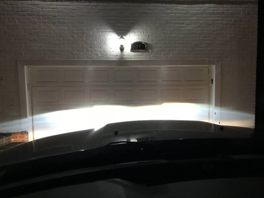

It is less about thick skin, but more about I just don't go out of my way to make someone feel bad about what they have invested in. By the way, I went to Baylor University, and grew up overseas (as an American expat), so not really a Yank, or a southerner.
This is a proper cutoff:
Notice how, there is no spilled light on the drivers seat on the car to the left or the back of the seat on the car straight ahead:
