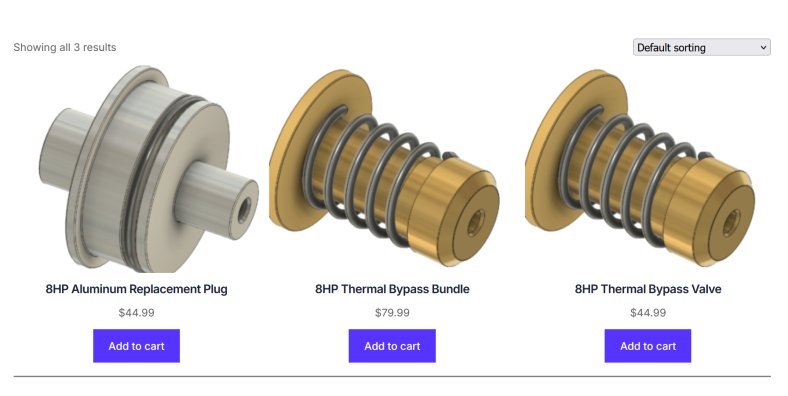

If you're going to keep your truck long term you may also want to consider upgrading to a PPE aluminum pan, AND getting the @caulk04 transmission bypass valve upgrade, too. These will significantly reduce your trans temps and help to ensure your transmission has a great service life.

Changing the fluid and filter is hugely important, and it's also a great time to install the @caulk04 transmission cooler bypass upgrade. It drops trans temps significantly!
Couple this upgrade with a new PPE aluminum trans pan and you'll have more fluid volume and much better temp control.

.......Changing the fluid and filter is hugely important, and it's also a great time to install the @caulk04 transmission cooler bypass upgrade. It drops trans temps significantly!
I plan on tranny fluid change soon, with a new PPE pan for sure.
How do I know if that cooler bypass upgrade will work on my truck?
If you have the 8spd trans it will work.
I would opt for both the bypass valve and the aluminum plug.
https://yourautohuckleberry.com/store/ - is the place to purchase, and installations are straight forward.
I have personally purchased over half-dozen of them for myself and family & friends
@caulk04 has a distributor (named above) and he is solid to work with.
I have purchased from him several times and it is always spot on service and quick delivery of the goods.
