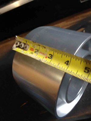

So I complained to the eBay seller about the 3" front level he ImageUploadedByTapatalk1390675453.224945.jpgsent me only lifted a 1" . Then he sends me this .....(see picture) I am not sure if his is a joke or the 3" spacers are really that freaken big !?!? Can anybody tell me if they have a spacer this size in their truck or seen it ? Its 2012 ram 1500 2wd .

yes the spacer In mine (2.5inch) was about the same size, the coil spring sits inside it, and then the spacer sits inside where the spring used to.. So if your "3" inch spacers werent this big then you received the wrong parts.
sausec17
Banned
Apr 22, 2012
2,199
445
ATLANTA
take a measurement from the inside, where the coil sits, to the bottom of the spacer. Then subtract that from the total 4" measurement. Thatll be your spacer height. Usually the spacer measurement is half what the lift height would be.

it measure 3" so it will lift 1.5 ?

if it measures 3 it should be a 3inch spacer. did they send you the wrong one maybe?

I honestly don't know lol and I hope not . The last spacer was about 2 inches and it lifted 1.5 . lets see how this goes ! I plan on doing it sometime this week . Im dredging doing this again ! Compacting the spring is a pain ! I will post pics when Im done with this new adventure !

My previous spacer measured 3.25" overall and 2.25" between top coil to top bucket (actual coil size) once installed. It actually gave me ~3.5" of lift.
The geometry of the suspension makes it hard for knock-off manufactures to understand.
I finally realized to stick with "top brands" as they have actual R&D made specifically for our trucks.
If I were you, Id return these junk spacers and stick with either Maxtrac or CST for anything 2wd. They have the money, research, design, and knowledge of our trucks. Tested and proven.

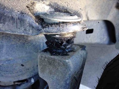

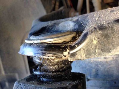

ImageUploadedByTapatalk1392466733.237222.jpgImageUploadedByTapatalk1392466752.469838.jpg
This is why you don't use longer shocks. I have longer shocks and cradled my upper control are because the longer shock allowed too much travel allowing the upper control arm to have contact with not only the shock bucket but the spindle as well.
