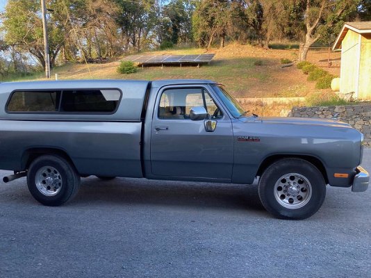

Nothing beats a real diesel engine without electronics.
My best friends 12v = 25 mpg's verified. In fact, he went on a trip that was more uphill, and he got 23 mpg on the hilly run and 25 mpg returning with the less up hills. It is his daily, plus he tows a mini x for his job. You don't wanna know what he paid, lucky barn find bastage! It is a sad state of affairs a 30 plus year old truck has a better outlook then brand new $100k diesels. It gets worse, the OP has the cp4 pump most likely, so the chances of this truck being on the road as long as any 12v, well you know where my bet is on that.
DILLIGAF
Canadian Forces
May 28, 2016
5,750
12,273
Canada
Holy ***** that thing is clean , :peace: I tried to find a 12v but a 5ton IHC was cheaper ...lol.
I just took my new to me 90s IHC out for the first time today. No CP4 Disco party here.
They sounds awesome
