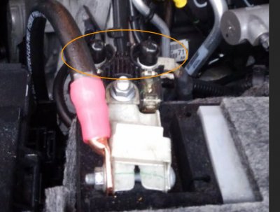

I also noticed I am missing the little black caps that cover the bolts on the fuses off the post terminal - anyone know of a good source for those w/o buying a 100pk
