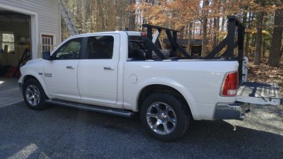

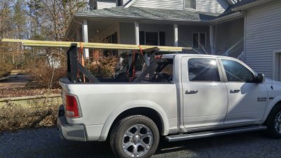

I have wrestled with the dilema of choosing between a tonneau cover and utility rack. The tonneau is much more desireable as a full-time accessory for me. I don't want a rack on my truck full time; only occassionally when I need it to haul lumber or ladders or canoe and don't want/need to use my trailer. My search did not reveal an easy-on-easy-off rack without drilling, that would fit with the tonneau cover, and was inexpensive. This 2x4 rack slides in, fits perfectly, is strapped in with ratchet straps - one front and one back - and won't move front-to-back or side-to-side when in use. It will carry a serious load (though it would not be wise to carry really heavy loads so high up for obvious reasons). When I don't need it any more I undo the straps, slide it out, and set it on a couple of boards next to the trailer. Takes less than 5 minutes to install and remove. I did not put the lower diagonal braces on the rear portion to allow full-width access to the bed from the tailgate. Works great and doesn't look too bad either. I like it alot. Maybe some of you will too.0131181123_HDR_resized.jpg 0131181123_HDR_resized.jpg 0131181123a_HDR_resized.jpg 0131181124_resized.jpg 0131181253_resized.jpg 0131181123_HDR_resized.jpg 0131181123a_HDR_resized.jpg 0131181124_resized.jpg 0131181253_resized.jpg

Nice! Be happy your 2x4's aren't round. I fabricates a rack, "ago", out of steel tubing... the whistling drove me insane!

No noise with this one. I don't even like it when the ladder up top whistles in the wind.

Yep.. always struck me strange that round whistles and other shapes are quiet.

It's the wind passing over the open ends of the tubes, like when you blow accross the top of a beer bottle.

I filled the holes with caulking on my ladders and it will stop that. Sure something like great stuff foam would work better.
