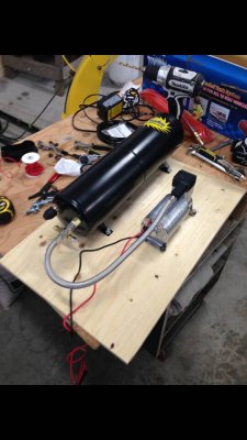

Here's a pic of the tank and compressor mounted to plywood which I then mounted into the tool box. Worked awesome!
Sent from my SM-G900W8 using Tapatalk
