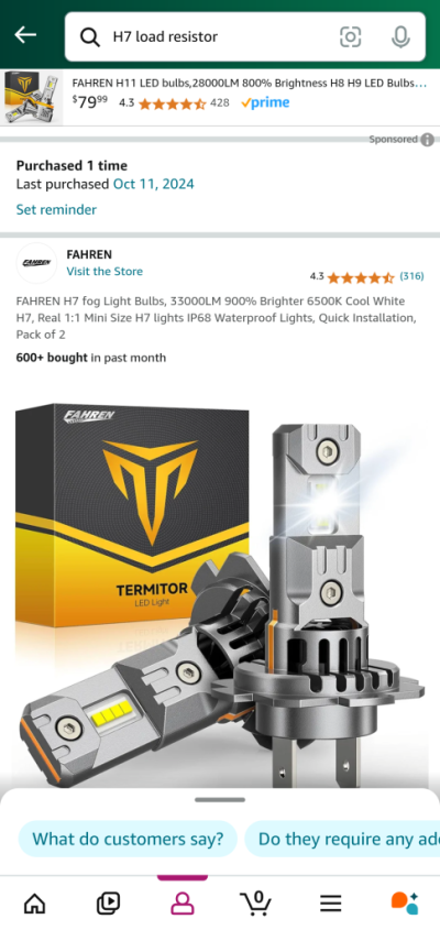

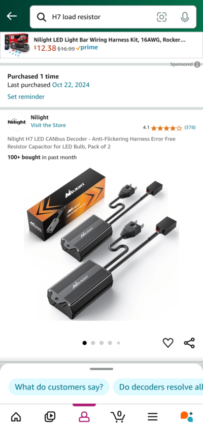

I have a 2021 RAM 1500 Classic 3.6L. I changed out the headlight assemblies to new ones that take H7 bulbs. I swapped the halogens for Fahren Termitor LEDs. I had a flicker which I didn't with the old assemblies I put LEDs in. Contacted Fahren and they said to try Nilight CANbus decoders. I installed them and the flicker is still there. What's the next thing I could try?
I read to try load resistors. Being new to the LED flicker, not sure if those are similar to the decoders. I read about them and it says they need to be mounted to metal but with the dust caps, I can't get wires through without drilling which I'd rather not do because of moisture in the headlights. When I originally installed the new assemblies, one of the dust caps was slightly loose and caused moisture to get in.
Attached are also the bulbs and decoders I bought.
