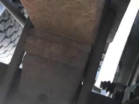

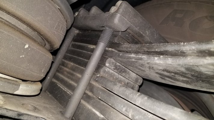

Umm, I kind of have a similar question. How would I know if my truck has a lift installed if I'm the third owner and didn't ask?
I was crawling around underneath the other day and noticed that between my rear axle and springs there are 3-4 spring width metal spacers. There is about 1-1/12" between the axle and the spring. I always thought it looked like it had a mild lift but I don't have a stock truck twin to compare.
I don't see them in the service manual but that might be a generic picture.

Picture would be easier to follow.
Some factory spring packs, mine for example, come with spacers to get to the factory set height. I moved the spacers from the bottom of the pack to the top, which lowered the back approximately 1.5".

as a safety inspector in my state i can say that we measure them much the same way that 18CrewDually has mentioned. and just like his truck mine with the factory suspension has spacers under the springs in the rear and a factory leveling kit that raises the front end 2". I had to look at the build sheet to find that out. Easiest way to measure your lift is to measure from bottom of door to ground or top of the wheel well to ground and compare to a truck that you know is not lifted. Or you can take it to somewhere that installs lift kits and ask them to look at it!

That is typical from factory.
I moved the 2 that you see on the top from the bottom to lower the back so it is closer to level. Mine use to look like yours. This has no effect on sway bar or the mounts.
