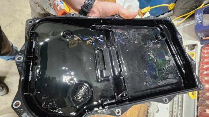

Well it looks like this after 68000km :doublepuke: The Valve Body didnt have any issues.
Il be doing mine again at 120xxxkm.

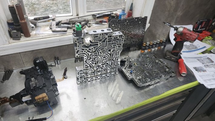

What was the purpose of the tear-down?
I installed the PPE Pan and Sonnax Zip Kit ;) when I did my 8 speed swap.
Anyone who says this is a lifetime fluid is full of sh1te ! Same goes for the fluid. Looking forward to see how the Maxlife fluid will look in 60xxx km
I've looked at that Sonnax kit. How was the install? Fairly straight forward?
