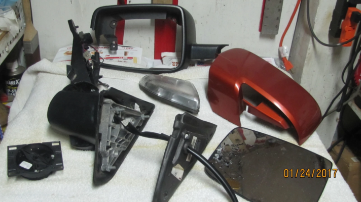

i did not think that the door module is programmable.
did you replace the mirror ?
one motor, one light & some darken & leave a brown spot on the glass
