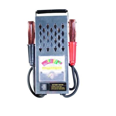

I had mentioned that I always get the pop up error on startup. If I have the Uconnect system on (listening to the radio for example) with the truck off, and I start the truck, the error pops up, and the Uconnect system shuts off and I have to hit the power button again to turn it back on after the truck starts. Does that sound like a possible battery issue? Thanks again.
Could be but you would need the have your battery load tested using one of the old school toaster style battery testers like this pic. 1772747511090.jpeg
