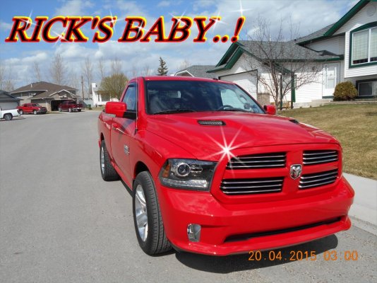

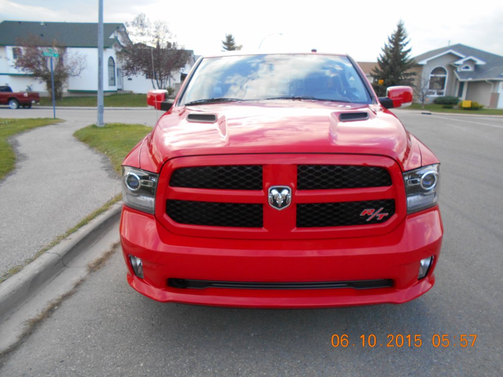

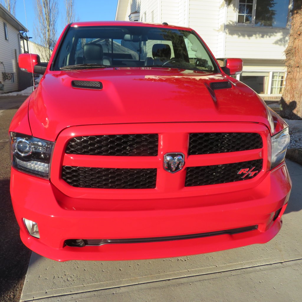

Don't have to go anywhere - 2014 Ram Sport still relatively new to me. No indication of overheating, but cruising into 3 days forecast as 106°, 112°, 100° and hotter on the road, when does it make sense to just hunker down? On another site, a familiar user talks about performance reduced on his high performance car at 115°. Thoughts? Yes, the truck A/C seems to work just fine.
As Paco's stated if you still have the original Sport grill in your truck,it's a big factor in how much airflow makes it to the rad. If you ever stumble across the open honeycomb style grill it's a far better grill for cooling. You can also remove the center slats on the active shutters if your truck has the 8 speed,flex them in the middle towards the front and they'll just pop out,leave 1 top and 1 bottom shutter in place on both sides,and you won't have any codes pop up for them.
Here's a couple pic's of my old 14 Sport,showing both the stock original Sport grill and a pic or 2 of what it looked like after i replaced the center of the grill with the better flowing honeycomb grill,which also looks a lot better then the original grill ever did ;)

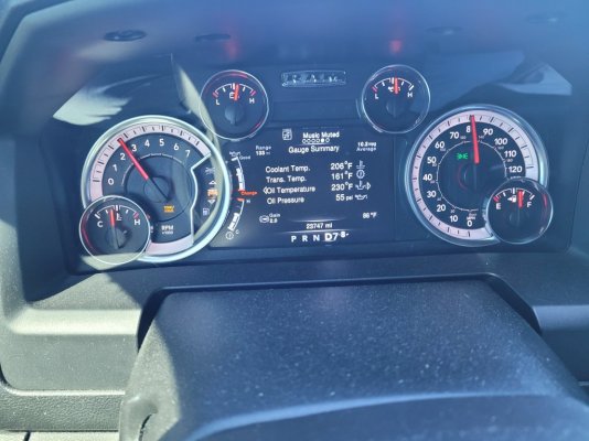

Here ya go
Towing the tandem 7x14 with 2, 900 lb Harleys across North Dakota today, headwind and 86. Lots of 6s and 7s, very few 8s to maintain the posted speed limit. Warlock is bringing the pain on fuel economy. Holding it's on every where else
