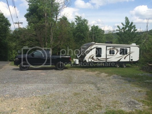

I installed my Zone 6" lift this spring and it is doing well. I have towed my camper about 8 times since and have no issues. Last month I hauled about 1200# of cast iron radiators in the bed, squatted a bit until I aired up my air bags but no issues.
I have the 5 inch coils in the rear and Rancho Quick Levels in the front. Gave me about 5 1/4 inches in the front.

Very nice looking rig ! What's that trailer weigh loaded ( bout 6k ) ?
How do you like your air bags ? I'm contemplating between air bags or a spacer to maintain level when hauling camper or boat .

Loaded is about 6500, I use it for work so I travel heavy, live in it for months at a time. The air bags are great, Boss Air Bags makes a kit for lifted Rams. I paid about $325 for them back in April. The ones you insert into the coil springs will not work, the coils on the Zone springs are a bigger inside diameter than stock so the bags will not touch the coils. I run about 3# of air day to day and bump it up to about 10 with the camper on.
