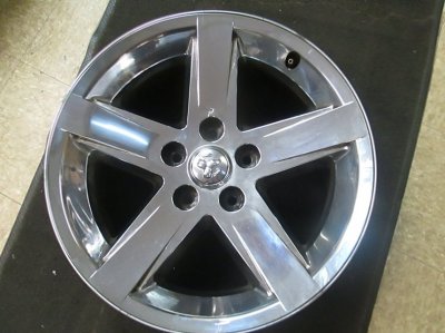

Hi fellas! My buddy sold me his 20" wheels off his 2012 Ram and I was wondering how many different type of tire sizes fit the 20" Chrome Clad wheels? I ask this because I might be able to get a better deal on 4 brand new tires that might be a little taller/shorter and/or narrower/wider! Will I run into any rubbing/fitment issues?

Depends if you want a bigger tire are you lifting the truck or if you want a smaller tire maybe your dropping the truck.

I'm running 275/65r20 on sport wheels and stock suspension and have no rubbing or other issues. The wheel is right at 34" height.

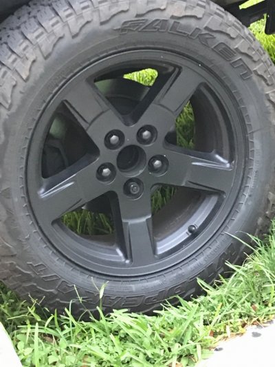

91c54513ee47011ecf9e4c07a97a3223.jpgthis is how they look if you take the chrome clad off and paint it black.
