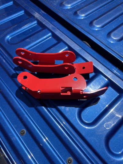

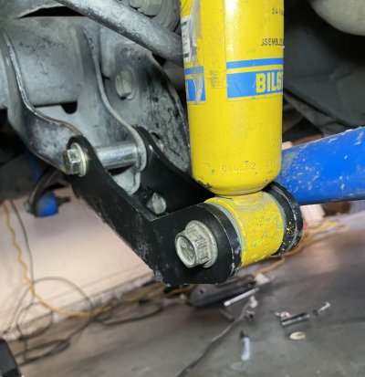

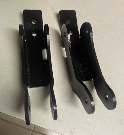

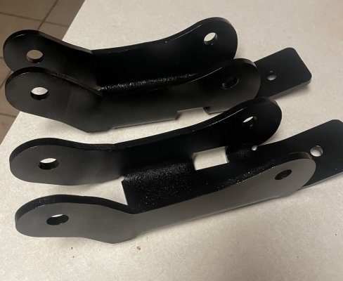

Looks great. How do you like the shock relocation brackets and where did you get those?
Great fit and function. I'm very happy with them. I bought them from a facebook forum member that makes them. I think he's a member on here. I'll contact him and see if he can chime in here.
17BlueStrkPearl
Jan 22, 2017
11
To anyone interested in the shock brackets. I’m the guy that gets them made. I don’t have access to the “For sale” page as I rarely get on here anymore. But if anybody is interested in them. Shoot me a email at [email protected] it might take a few days for me to answer but once I do, I’ll give you my number for texting.
