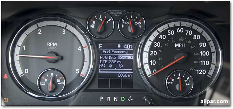

CuylerTech
Nov 30, 2013
3,633
961
NH
2015 Big Horn Mega Cab 4x4
6.7L
Can this be changed as plug and play on the 2011 Express as well? I want the updated cluster if possible.
No, the 2009-2012 Clusters have a different plug then the 13+ do. You're only option for a nicer cluster if you do not have an EVIC Screen is to get one of these clusters that have a 3.5" evic screen gauges.jpg
