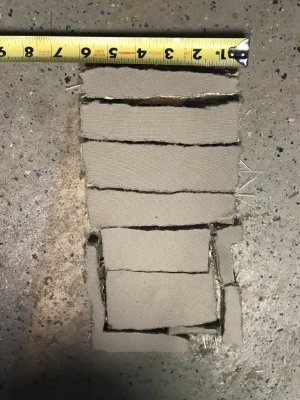

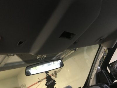

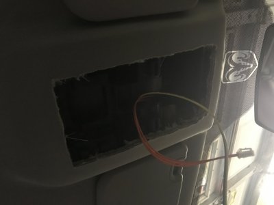

I've been pining after this upgrade for a while since I got my '12 Ram1500 Express. Figured I'd show off the process. Hardest part imo is the electrical as no one really has anything except electrical diagrams and some people (like myself) are more visual learners so we don't tap into the wrong thing. So the physical side of things is all buttoned up, just need to wire it up (waiting on the LED bulb upgrades anyhow, so I didn't finish the complete install anyhow).
Starting.
Visors and A Pillars removed
First (of many) holes cut. Everyone warns you to start small and cut as you go after plate is installed above headliner. 100% good advice.
Visors reinstalled with overhead console plate behind headliner.
