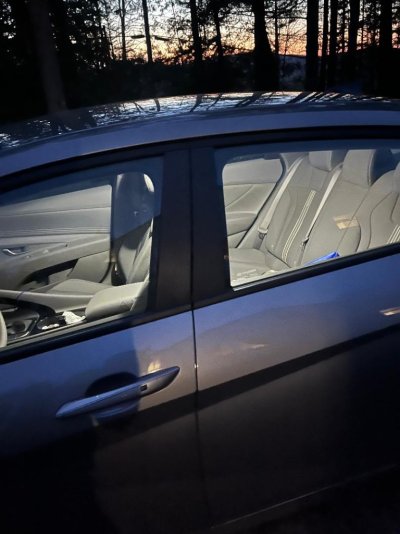

Good write up ! I agree with using LASFIT bulbs ! I went cheapo E Bay specials first round ! Went to LASFIT and Auxito and they were way brighter
My car with LASFIT bulbs and Auxito ! I have to get a new picture of the truck but you getthe idea
