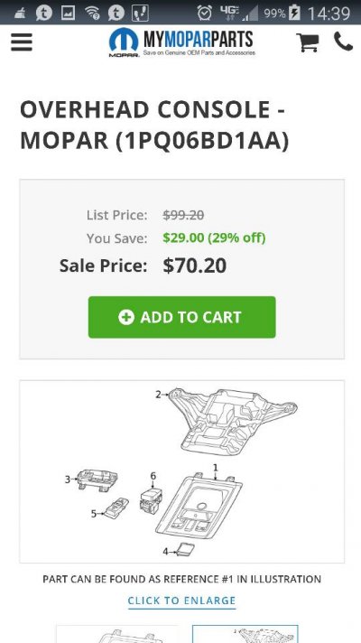

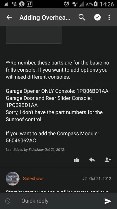

Looks like this is the P/N you desire . This is a screenshot of the OP post #1 of this thread .
Remember to make sure you have the dual module for compass & Homelink or you will still only have the compass and homelink won't work . Your harness you have now will work fine , the compass & Homelink utilize the same 3 wires within the harness you already have .
No codes are required for you to do this .
Hope this helps !
Another one here
A post with the dual module p/n
I found the console and module on ebay as well !
Good luck !

I belive the p/n s you need are in my post above .
You'll need the console with the Homelink / garage door opener buttons assy installed in it OR as cptwing alluded to = cut your console and install the garage door buttons .
You will also need the Homelink modual , which doubles as your compass module .
Personally I'd purchase the Homelink colsole assy . Which should come with the console with lights ,dual module for compass & Homelink and the garage door buttons already installed .

So if I am following now it appears I would want the 1PQ06BD1AA. Am I correct?

That's what I think . I'm also thinking this is a plug n play for you because you already have the overhead console with a working compass .
I'm not 100% ( I have not done this ) but I believe this is the one you need and it should have the lights , garage door buttons and the correct Module for the compass & Homelink.

The p/n you have listed above as a console is not the console , that is a p/n for the compass module that attaches to the console .

That P/N isn't the console P/N that is the part # of the dual module for compass & Homelink function . Just the module is worth more than you paid !
