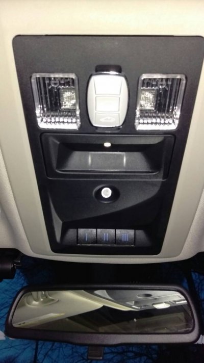

I just finished installing a "all the bells and whistles" overhead console. Homelink worked plug and play.
I found that the older 4th gens have a different "night light" that goes into the cone-shaped opening. I'm currently toying with the idea of hooking it up as it points more towards the back seat. It will require splicing some wires and has a 3 pin connection unlike the pin-hole light which is 2 pin.
In addition, this overhead has the factory LED map lights. I may or may not swap them for the bulb type map lights from my old overhead console. I'm thinking I'll probably just cover the reflector in red film and call it good (my old bulbs were red LEDs for preserving night sight).
