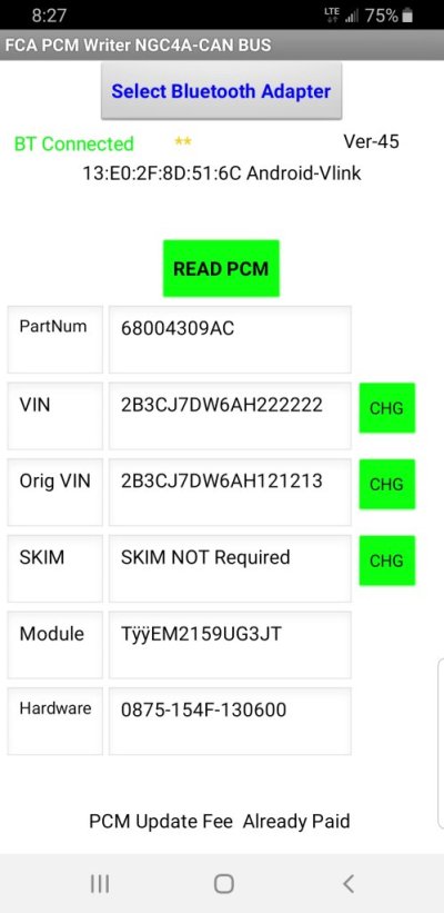

YES - This works on CAN bus PCMs using Elm327 Bluetooth . For JTEC and NGC3-SCI you need my hardware.
2005 Dakota is NGC3-CAN.
go to skimdelete.com
Download APP - Android Only
Plug Elm327 BT into OBD2.
Pair Android BT with Elm327 BT .
Start APP ....
Enjoy.
Start APP ....
Enjoy.
HemiLonestar NOT A SCAM !!
I have a question, I have the same dongle however I can't get this to work for me. It connects but it doesn't populate the Vin or skimm. What am I doing wrong here??
