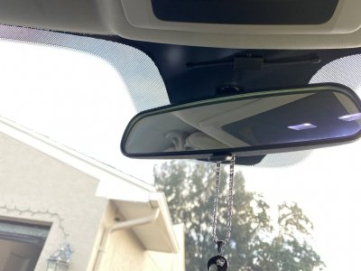

Now that I’m not at work, here’s what I was talking about. This antenna plugs into the part of the OEM antenna cable behind the glove box. This way, you neither have to pull the radio out, nor even leave the cab to run a new antenna line. I ran mine up the passenger side a pillar and stuffed it just inside the headliner so it’s completely hidden. I also completely removed the factory antenna because of my snorkel, so that gave me a new entry point into the cab for running wires.

I bought it. For 9$ it’s worth a shot.
https://tinyurl.com/y7395ooo

Antenna came in. So I’m already running a 13” stubby that I did not notice any signal loss vs stock whip antenna. I installed the Amazon antenna and noticed signal loss on non local stations. Ran it directly to the back of the radio to prevent as much loss as possible. I’m giving it a bit just to see how I like it before giving an official review.
