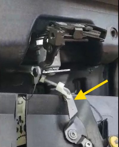

He got the box open. Had a locksmith come out and he used some air wedges in the lid to make a gap where he could grab the emergency release handle to trip the latch.
Turns out that with the power actuator and cover removed, there was still the link from the lock cylinder that goes to the lever for the actuator motor. When the lid is closed, that link hung down and jammed into the lever on the latch that the lock cylinder needs to operate. The rod is the one with the red arrow below. This means that if that clip were to break and that rod is hanging free, it could jam it again. It also cause the button to stick halfway in. I've seen that symptom mentioned before.
