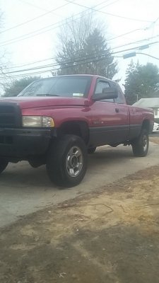

Paul Christiansen
Dec 14, 2018
New york
1998
5.9 magnum
If it helps here are pics of my truck, i know not the prettiest but this is all part of the transformation. The tires are 285 70/r17 which is equivalent to 32.7" tires aparently.
