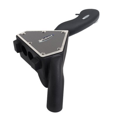

someone experienced the Volant CAI?
i looked for the ram scoop, but it needs the srt10 hood... affraid the shipping will be expensive :Pshyco:

just to say i edited the post with pics of the Volant CAI and the scoop...

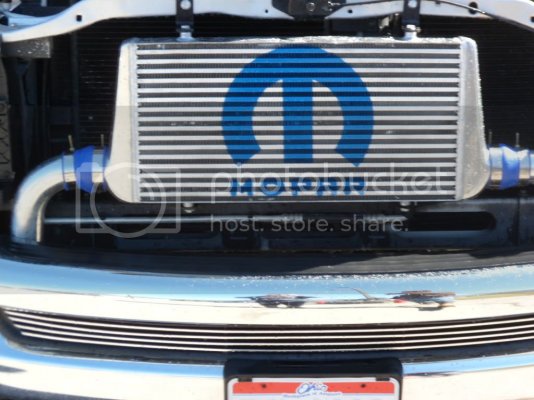

johnnysart
Jun 27, 2010
2,998
257
Albuquerque
2002
5.9 Magnum

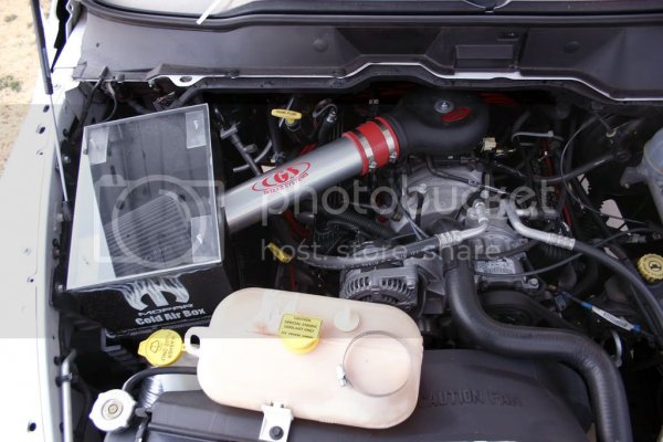

woow
do you have a review of all your mods and some pics of your custom CAI?
I'll post up some pic's of the cai. all my mods gave me modest gains, I believe one of my favorite and most noticeable gains was from the harland sharp 1.7 na rr. Thinking of a bigger cam and 4 56's down the road. I usually feel it more at top end.
not even close to being worth it. lots of work for minimal gains. get a real cam for your needs. and this will wake her up. it did mine.lol
:drool: Damn that thing is sexy. Looks familiar I believe my neighbor put one of his on his dak r/t.

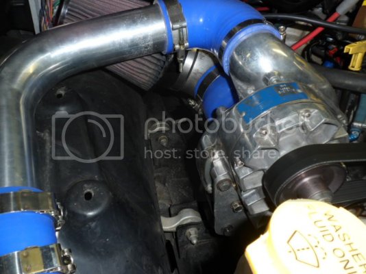

talon6
Jul 1, 2010
1,180
28
ohio
2002 QCSB 4X4
supercharged 5.9
thanks. yep they are the same on a dak as on the ram. couple more pics.
johnnysart
Jun 27, 2010
2,998
257
Albuquerque
2002
5.9 Magnum
zack, thats one badasss engine.

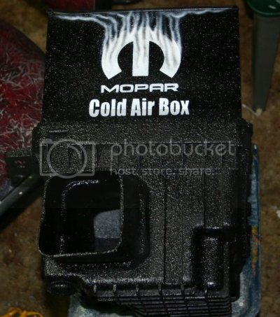

Heres my cai box I fabbed up out of the stock bottom half and the top half I made out of plexi glass.
Reactions: Mop
