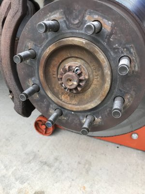

What is the Nut size on a ‘06 2500 4wd?
I thought it was 44mm, nope. Doing a Google search lead me to a Forum where they said 1 11/16, and a video I found the guy used a 1 3/4. Any help is greatly appreciated.

I’m looking for the size of the HUB / Spindle Nut, the one with the Cotter Key. Thanks @HemiLonestar .
Sorry I didn’t specify that. Lol!

OHHHHHHH....my bad, here ya go:
5086660AA, 1-11/16" seems to be size, which works out to a 43mm
