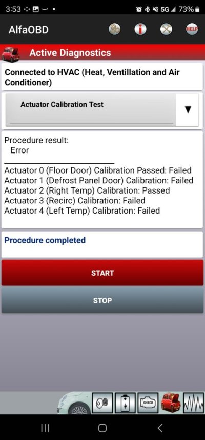

Im having the same problem with my 2013 5.7 1500, i replaced the heater core and the
4 actuators.(i do not have dual climate zones)due to no heat on the drivers side. i double checked that the blend doors function properly before putting the Hvac box back together. i tried to calibrate the actuators using OBDlinkmx+/Alfa obd app, but failed due to 'limited travel'. The actuators seemed to have lost communication with the mode and temp dials. repeated efforts to calibrate have failed. the climate controls have power. im lost...
