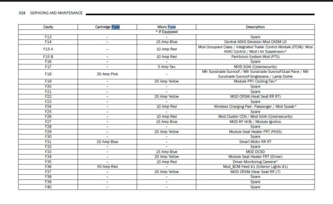

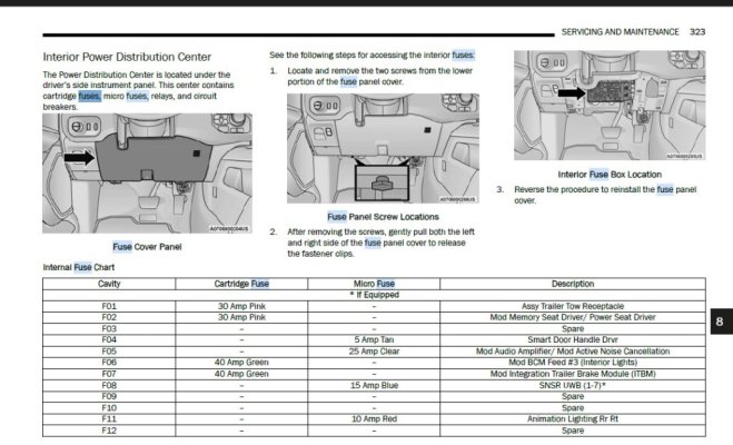

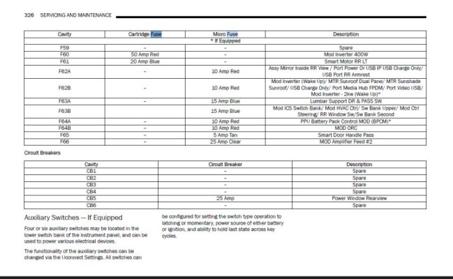

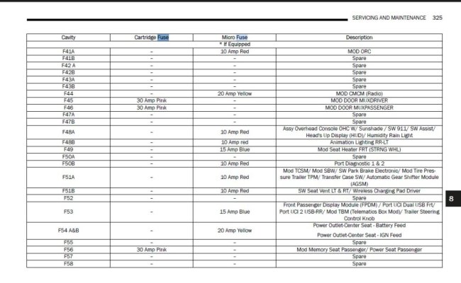

FUSE LISTING:
Interior

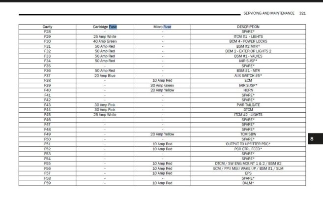

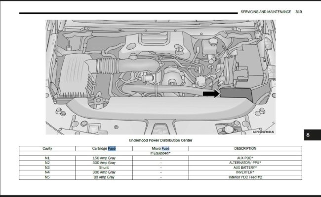

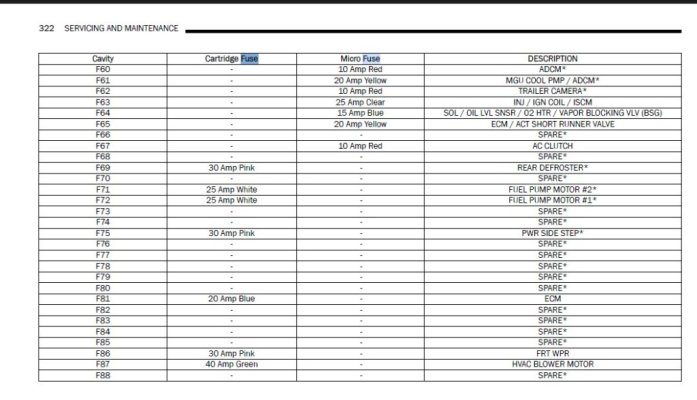

Fuse Listing Exterior:

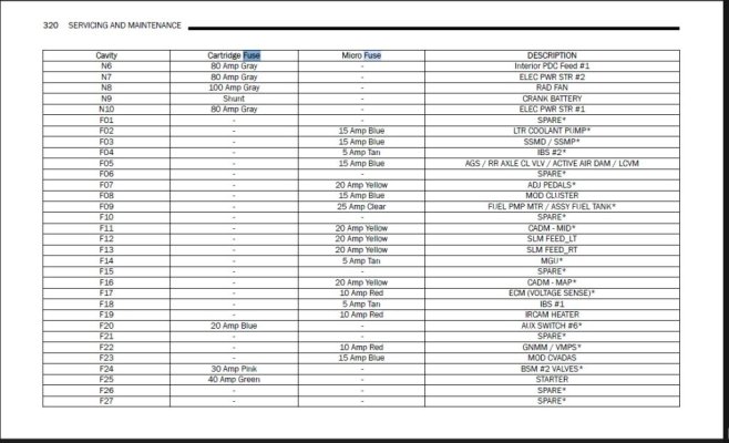

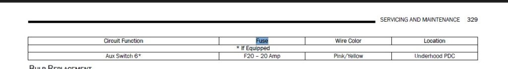

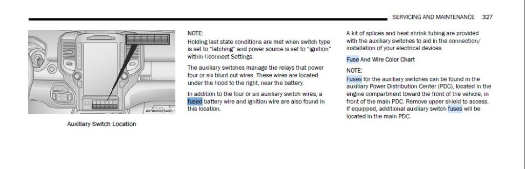

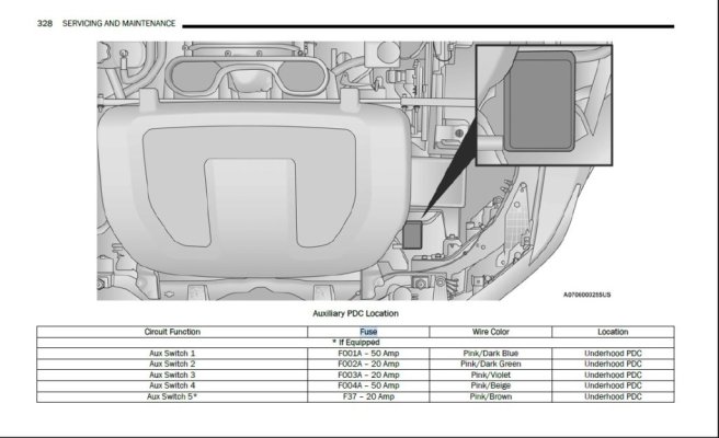

Auxiliary Fuses:
