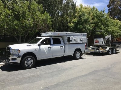

After work today, I got under the truck myself with a couple of bottle jacks, 2x4s, a tape measure, and an 18mm socket and was able to push the cab into perfect alignment. The cab, bed, bumper, and mounting points are all within 1/8" of exact measurement. The dealer did a sloppy job for sure. They just moved the misalignment from the rear to the front, AND left a dent on the bed side panel. I was not sure if I was potentially opening a can of worms at the start, but It feels great to have my new truck all dialed in. I went ahead and put the camper on, and am now ready for the mountains and deserts of the West!.
