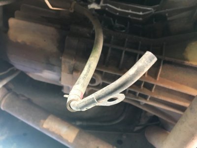

image.jpg So there’s a hose dangling next to the transmission on the passenger side can anyone help me figure out what it is

Vent tube probably.

That is either the transmission vent hose or the transfer case vent hose if it's 4WD. The bracket that is on the hose is supposed to be bolted to the bellhousing.
