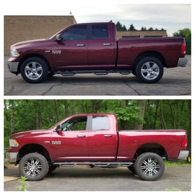

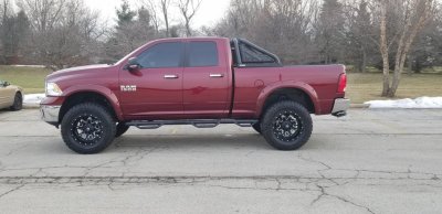

I also have the zone 6/5 lift. Set my bils at 2.1 and left out the preload spacer. My truck does not sit level with that setup tho, it has a slight rake to it which I wanted since I sometimes tow but still isnt as bad as factory rake. Truck is on 37s
bigred74
Dec 20, 2013
1,163
658
Illinois
1999 and 2017
5.9L Magnum and 5.7L hemi
Oh also here is how that setup looks with the 35s
