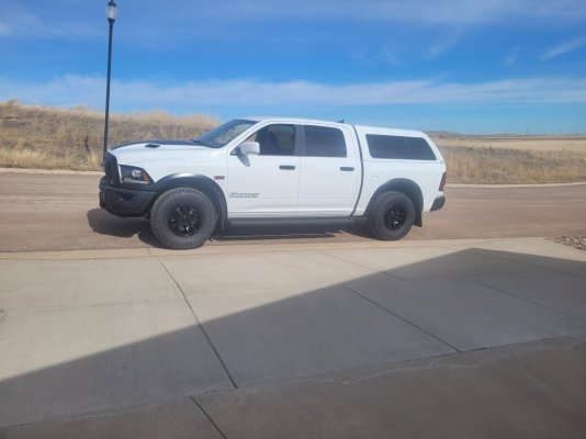

Here is my 2024 Ram 1500 Classic Warlock with 315 70 17 with Zero suspension modifications.
now I did add .375 hub centric spacers, to space the front tires out from the upper front control arms a bit. I had 3/8 clearance without the spacers,, which required longer wheel studs and different lug nuts. However if you go with 11.5 wide tires vs 12.5, you can avoid all this.
I've got over 12k miles on mine, with no rubbing and no issues.
my tires are 315 70 17 which are 34.6 inches tall, 12.4 inches wide and obviously 17 inches for wheel size.
I hope this helps. If and when I ever lift the front end, it will be with bilstein 5100s or 6112s set at 2.1 or 2.4 respectively.
