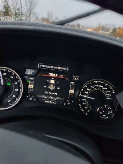

44 F 34R and I could go lower but I get perfect wear. No reason to have E rated tires pumped up for max capacity when you are not even close to max capacity. Realistically 25 psi in the back and 30psi in front would be fine. Weigh your truck at a Cat scale and see what our axle weights actually are.
Thanks! Did you have to change your TPMS settings?

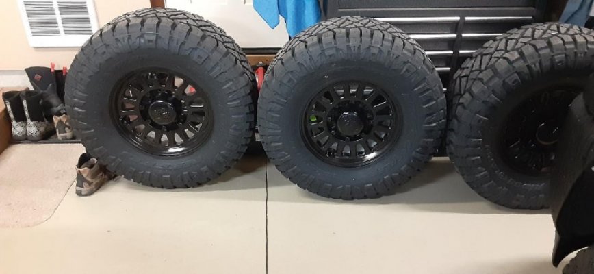

there is no way you are an inch shorter going from 35/12.5-17 nittos to 35/12.5-17 toyos. that would mean the 35's toyos were 2" taller to beging with, be like going from a 37's tire to a 35" tire to lower it actually 1". Toyo MT's are awesome tires.
you'ld be surprised what the actual height of any given tire is at full inflation compared to the stated height.

no I wouldn't lol. I have had more tires in the last 6 years than most. I measure each one. I have had nitto rg and Toyo mt on the same exact wheel ie AEV saltas sitting in my garage. I am actually embarrassed at how many different sets of tires I have had. I have had some that I put less than 500 miles on. Most tho I keep about 10,000 to 15,000 miles. It is a sickness no doubt. The only tires that I have come across that are close to stated size is Interco tires. I will leave you with this if you put your nittos on a set of Saltas they will measure just under 33.5" on the truck.
