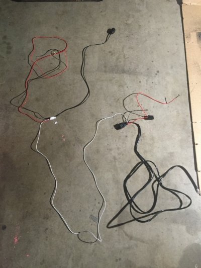

Someone explain this for me.
My light came with two different harnesses. One makes perfect sense.. The other, Im not so sure about. Though it's not a huge deal because I will be adding/soldering my own wire into these to make my "custom fit" harness.
I still would just like to know why one looks like this:
If you follow it from right to left, at the end of the white wire, theres a connection for the switch wire (I will not be using these switches).. 2 wires run up to the switch, and then theres those other 2 (long red, shorter black).. What is the purpose of these 2 extra ones branching off?

The switch has a light in it so power and ground
I was thinking that. So it's basically intended to connect to power/ground inside the cab?
Cause it damn sure isn't long enough to reach back into the engine bay. Oh well, thanks for the info!

So if I were to go with a three prong switch.. Where would I pull my power from inside the cab?
And when I add two to three more switches.. Can I pull power from the same place?
IMO
As long as you are using relays, just tap into the key-on accessory port power.

Yeah, the 12v power outlet is what I used. It is easy to get to and there is nothing important on that circuit. With that harness you got, you will probably have a wire that is supposed to be tapped into power somewhere, then goes to the switch and then goes to the control side of the relay. That is the circuit to tap into the accessory port power.
The reason I mentioned the relay earlier is because if you just splice into the wiring for a 10A circuit like the 12v power port, then run it to the switch then straight to the light, it will blow the fuse. And might be too high of a draw for the switch also. But on the control side of the relay, the draw is pretty minimal. You should be able to splice in power for three switches, then to three relays.
