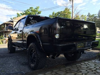

I should also add that I don't really want a side exhaust
something like these or just not see the tips at all

On my 3rd gen I did a Single In / Dual Out (SI/DO) muffler and it worked pretty well. It was easy to package and we were able to avoid having to figure out how to route pipes past the fuel tank which is on the driver's side.
The exhaust tips were just a bit outside the bumper line to avoid carboning up the bumper.
