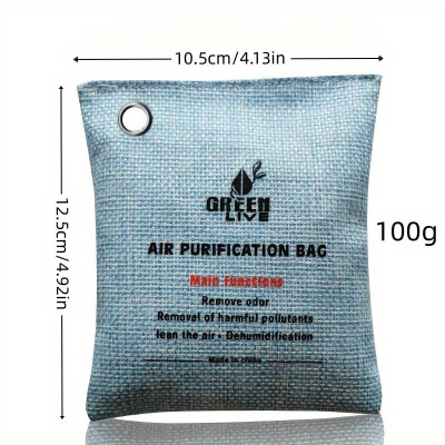

run the Heat, but only about 75 - 80 percent flow, then after a few minutes, turn on your Defroster.
As someone mentioned, clean the inside of the windshield
I don't know for sure, but i keep a small bag of bamboo charcoal on my dashboard in the center, against the windshield, i think it draws the moisture off & cigarette smoke too
Bamboo Charcoal Air Purifying Bag with Odor Control,​
Walmart, Home Depot, Lowes
$2.00 - 3.99, depends where you shop
reuse for about 2 years, put it in direct sunlight to reactivate it, every month or so
