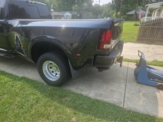

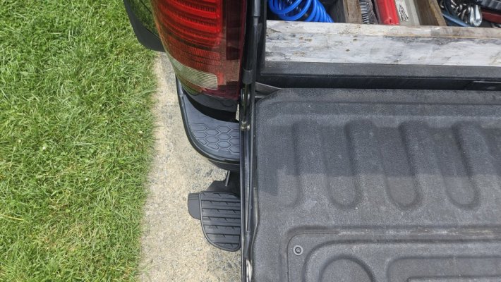

So I've been looking for an affordable price and decent looking pull out step. The ones recommended for a 2018 3500 are usually over $230 and ugly.
The other day while looking around Amazon and watching YouTube videos it appeared the 2019+ steps available from the dealer should mount the same on my truck. I compared pictures and took a shot ordering the step listed below for $104.
I just installed it and can't be happier. It's built very well and was a simple install.
The listing and pics below.
Make note, my truck is a 2018 dual rear wheel 3500. The bracket and the way it mounts fits perfectly and should fit other duallies prior.
ASOPARTS Rear Corner Bed Step Retractable Bumper Step,Compatible with 2019 2020 2021 2022 Dodge Ram 2500 3500, Replaces Truck Rear Tailgate Bedsteps # 82215842AE 82215842AC 82215842AD 82215842AH https://a.co/d/3uLCTLR

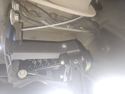

It's bright outside but the last pic is from underneath. It bolts to the two 15mm size bolts then you add the included bracket and bolt that to the 21mm size bolt on the frame. They give you new hardware but I opted to reuse the original. They were long enough.

If you need a better picture for verification let me know. Or post a picture of yours underneath on the driver's side looking toward the bumper. The main bolts are the 2 that hold the bumper bracket on.

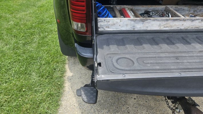

Could you show a picture of the step looking down with the tailgate open if possible? I carry a ladder and not the most stable thing. Also, how easy is it to get up and down? Do you find it is a natural feeling coming down or do you kind of hope for the best?
I will take a few pics in the A.M. My son has the truck for a little night out on the town . Lol
I haven't had a chance to use it much yet. But I installed one on my father's Longhorn dually last year and he loves it. He's 73 and does traveling Bass fishing tournaments (including MD) and he said him or his partner on the boat use it all the time, including when stepping to the boat trailer for launching or loading the boat.

Couple more pics below. As for as using it I'm built different (ambidextrous) so using it for me I'm comfortable using left foot on the step and stepping right to the tailgate. But if it was too much of a reach I also can go right foot on step, left on bumper, then right foot to the tailgate. The step in my opinion sticks out plenty.
