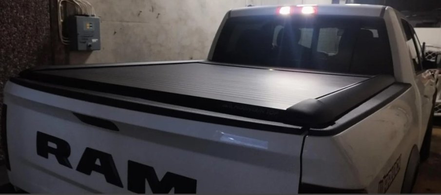

Owner is selling the roll top because he has mounted a bed cap instead.
I reached out to the manufacturer (Mountain Top is now owned by Real Truck) but they won't answer my question. Instead Real Truck is referring to their retailers here in Sweden.
I contacted two of them (trucker.se as well as kama.nu) and both of them are telling me that Mountain Top roll tops are only available for DT 2019+ models.
However, Trucker.se told me that they had sold one to a client that had a DS model and that client never came back with complaints. None of the retailers (and neither the manufacter Real Truck / Mountain Top) are answering my question "WHY" the EVOm won't fit on a RAM 1500 2013-2018 DS model (or a RAM 1500 2019-2024 Classic).
Here is a picture where you can see the Mountain Top EVOm roll top mounted on the RAM 1500 Classic 2022:
I'll keep on investigating...
