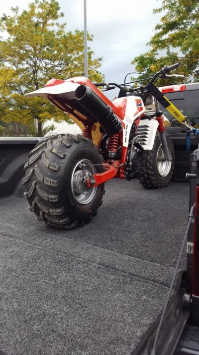

I have the factory sprayed-in liner and the bedrug. I only used the velcro/tape on the tailgate... it's all one piece. The corrugated foam keeps it from sliding side-to-side. I suppose if you put something very heavy on it and tried to slide it, it may move but I haven't had any issues. I don't have the bedrug sides, just the one-piece floor and tailgate. I like being able to take it out without getting in the bed.d878cb2af78794c1e123d8e5fe3e9caa.jpg781a8eee0ac566e6d5d498e5e8fb1ddd.jpg
